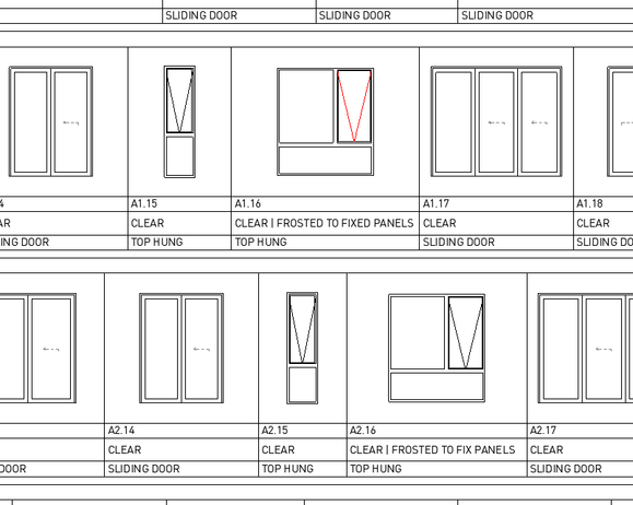

Some of the opening lines in my window schedules are not showing up... not sure why.
The opening lines are all showing up fine in elevations and in 3D. Maybe it's a bug? I have the same windows (different element ID) in the schedule but some opening lines just aren't showing up. The red opening line in the screenshot is the opening line that's not showing up.

Were both windows placed the same in the plan?
When you place a window you click on the side of the wall at the position you want the window to be.
Then you click the direction you want the window to open - left/right/inside/outside.
You notice this more with doors than windows because of the door swing.
I am wondering if you placed one with the 2nd click on the outside and the other on the inside (opposite side) of the wall?
Or maybe the first click was on the opposite side of the wall?

That's it! Thanks Barry.
