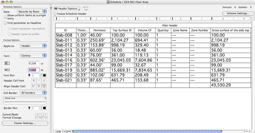

How can I get the Schedule to total the "Gross surface of the slab top" field?
Thanks Greg.
Thanks Greg.
click on the settings tab. Click the little square next to the GFA parameter to show the sum symbol. Hope that is descriptive enough.
Thanks Aussie John,
I got it to Sum.
Anchor1 wrote:
Thanks Aussie John,
I got it to Sum.
In case others are interested:
The little square "field" next to the GFA parameter only becomes visible once the "Schedule Field" item is selected. In my case it is the "Gross surface of the slab top" item.
see the attached pic.
