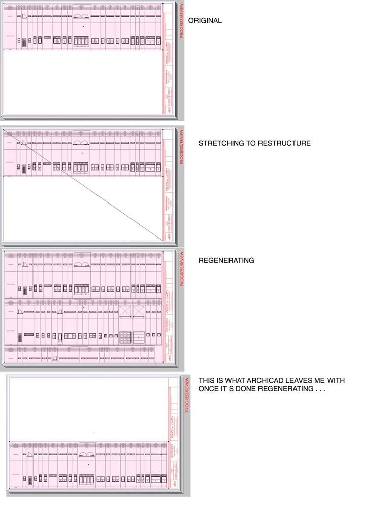

Can I not have my schedule by Restructured onto multiple pages if I want it to be more than one row big?

I just experienced yesterday exactly what you're describing. Couldn't get more than one row, and it forced itself to the bottom of the page.
I needed to get my schedule finished, so did it the hard way, copying it over onto multiple sheets and cropping what I needed. Not ideal.
So...I'm also curious if anyone knows a way around what you illustrate.
PS I'm assuming that you, too, have the checkbox for the schedule's drawing settings checked as shown in the attached...("Split drawing among multiple layouts")

Yes, I have that box checked as well.
And, I , too, the last time I made a schedule did it the hard way and just copied the schedule a bunch of times, but I had a few extra minutes before this has to be submitted so i thought I'd throw it out there. . .

Unfortunately this is something that we couldn't develop for the IS yet. We can either split the schedule among multiple layouts having one row on each OR have the schedule in more lines but on only one page.
There is a wishlist item about this functionality, I have added your comments to it to track the needs for this.
