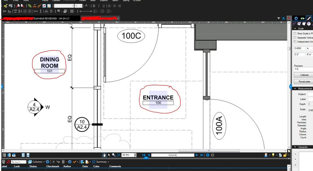

Currently using AC20 & publishing / saving PDF files from layouts, marquee model views, etc... When zones are used, the set area shows up in Revu as a purple transparent fill. These "fill" areas do not get reflected in any hard copy prints from Revu, only on the screen view within the program.
Also, if the PDF file created by ArchiCAD is opened with a different program, Acrobat for example, the "fills" do not get displayed in that viewer.
Has anyone else had this issue arise, and is there a setting within AC20 (or maybe in Revu) to have it not show up in Revu? It's more of an inconvenience than a major problem, but when a client sees them, they get confused. Thank you.
1 ACCEPTED SOLUTION
Solution
Turn off the space setting in Bluebeam

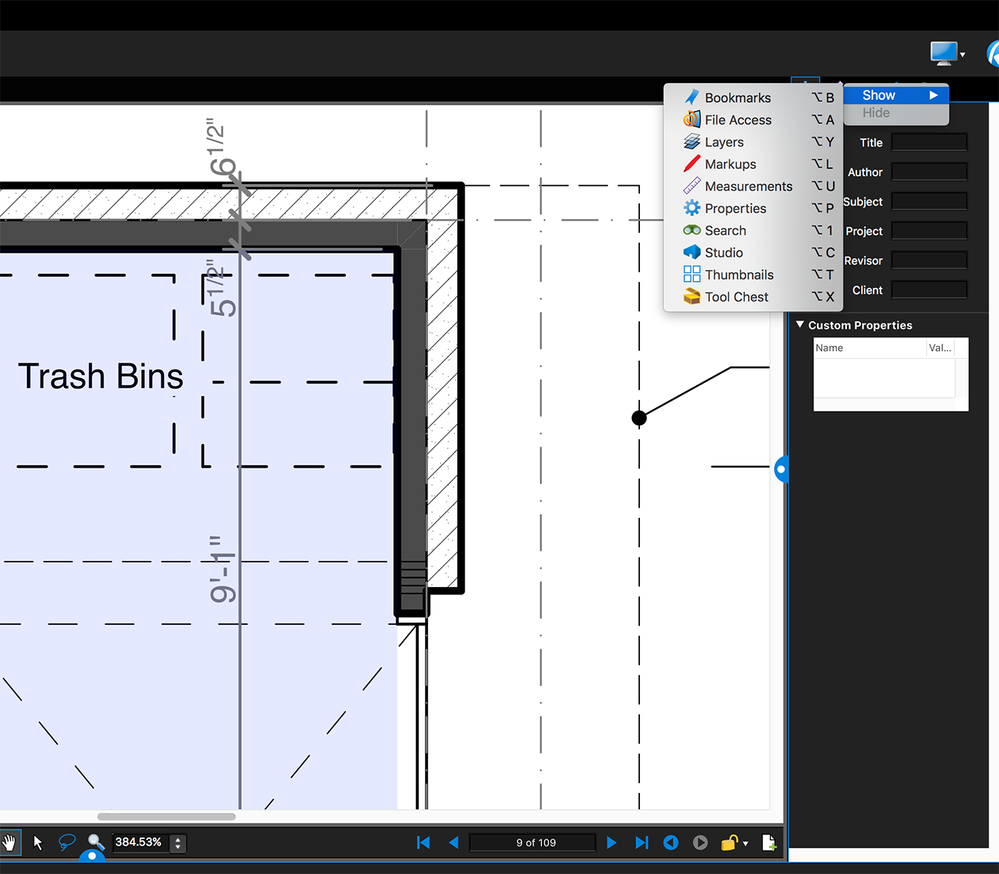

I'm having the same problem, but I can't find in Bluebeam Revu for Mac where this space setting is to turn off? Thanks!
Right click on right column > Show > Spaces) to view the office space.
This is for windows, sorry not sure about Mac
Yea...unfortunately Revu for Mac doesn't have all of the features yet that Windows does. So my options on that Show dropdown doesn't include Spaces. Bummer. What's the alternative - turning off the Zoning layer, and adding in text for Room Name/Number before saving as a PDF? Superb.
