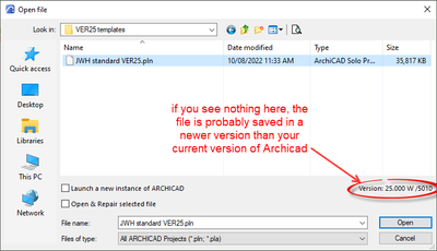

As Lee said, the only time I have seen that message is if I was trying to open a file made in a new version with and older version of Archicad.
i.e. the file was saved in version 26 and you are trying to open it in 25.
If you go to the FILE menu > OPEN dialogue, and select the file, you should see the version number of the file.
If you see nothing it means it is a version newer that your currently open Archicad and can't be opened.

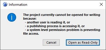

I also having a similar problem when project is meeting the deadline, the file suddenly show "Warning! Cannot read file plan."! 😱😰😭.
I m use Archicad 24 to draw the plan, but even I m used the Archicad 27 to open and repair. I also unable to open the file, and it show unknow document version, All the above that Barry has suggested I had tried, but the file is this unable to open and it shows this information. May know who and how to get help ASAP. Arhicad 27 File unable to read.jpg The reason is because.jpg
That message may come from (a) being in a cloud storage folder (or a folder that you told OneDrive etc to back up to the cloud), (b) an Archicad crash while working the the file, c) a user permissions problem that re-starting your computer may resolve.
Since it gives you the option of opening Read-Only, did you do that?  And then just save it as a new file?
