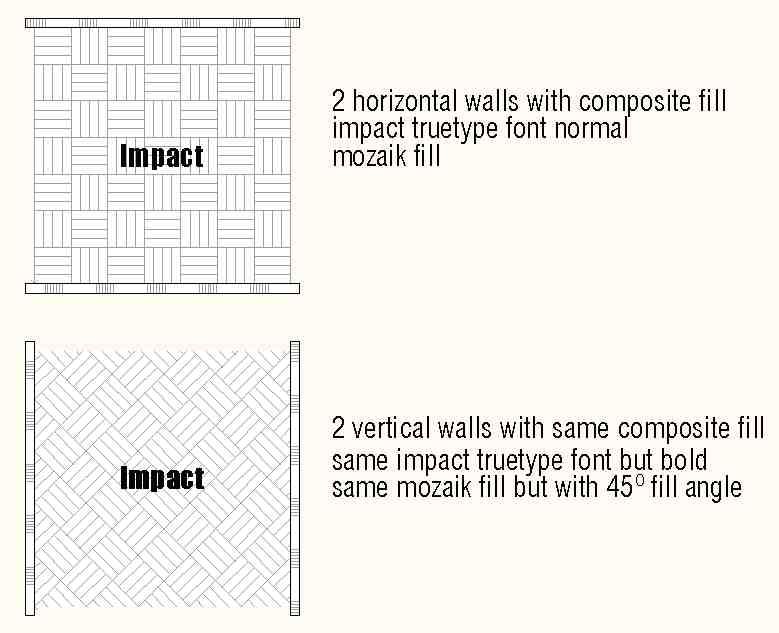

1. i can't seem to publish directly from archicad with hairlines, although in plotmaker it is possible.
2. fills with a fill angle do not publish correctly as dwg
3. autocad cannot handle the same fonts archicad can. even with a template-dwg, a truetype font like Impact will not appear bold in autocad.
the above are amongst other issues i have with dwg-exports.
Have I overlooked some settings, are more people experiencing these problems?
See attached images
Make sure your Display options are on Hairline, not True weight
Fills defined at an angle or fills with fill origin, rotated?
On your example, the font above does show the same, the one below does not. What is the settings difference in ArchiCAD, if any?
Also with display options set to hairline the published DWG comes out true weight, unlike plotmaker.
Fills with fill origin rotated, fills defined at an angle come out fine.
One is bold the other normal. I have Autocad 2000 and it doesn't allow the Impact truetype font to be bold.

Otherwise I have to use the normal Impact font from now on. As Djordje could not see any difference (see above) I guess I'm too critical about my exports
Although the fills with angled origin not being exported correctly is a real problem, as is the true weight issue

I updated to AC9 (1965) and tried exporting again...JACKPOT!!!
The hairline/true weight issue is fixed as well as the fills with rotated origin, all exported perfectly
