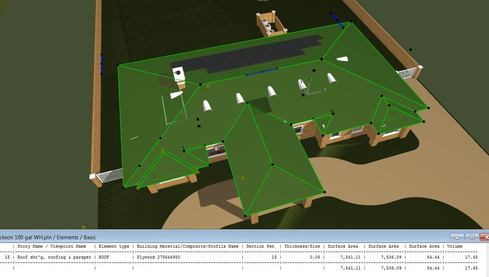

I'm trying to provide my client the total area of tile roof and would just like to
ask if I'm doing this right.
The first screen shot shows the house with all of the plywood sht'g selected in
3d and its basic information from the document/schedules and lists/elements list/basic
Am I correct that the surface area is 7,541.11 s.f. ?
3 REPLIES 3
this is another screen shot from 2d window with all plywood sht's selected.
Where do 2D and 3D views results differ? Does 7,500sq.ft seem like too much? Looks like a big house. What is the floor area? Roof pitch?
It looks to me like the main roof is constructed in a Multi-plane roof, while the two small projections at the left and right hand ends are separate (grouped) single plane roof elements. Is this correct? If so you have a bit of overlap where the multi-plane roof is under the add-on areas, giving you additional area (although not substantial). The three areas listed in your schedule would be top surface, bottom surface and edge surface.
S2art,
I had a different result between the 3d and 2d the first time I ran the 2 basic element lists, but now they corrispond. The number seems to be correct enough for me to trust. I will do a quick double check tomorrow. Thanks, Jonathan
