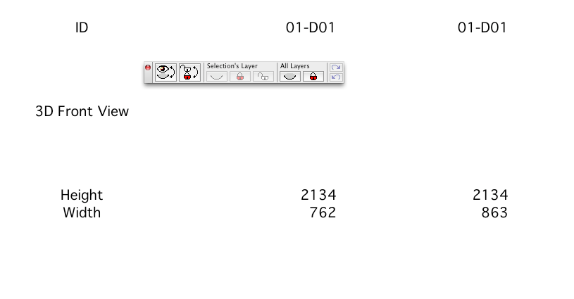

Bobby_ja_tt
hi guys now i have 2 new problems
i've been trying to solve with no success.
1. when i generate my schedule the elevation of
of my windows or doors are missing although the field is
there for it.
i'm guessing the file my be corrupted but I'm hoping its not
any ideas?
and.
2. i use the solid operation menu to do a subtraction with upwards extrusion
on a mesh(site) and slab(floor) but it does not work on some parts of the model or when it does work every time i re-open the file i have to do it again.
any ideas on this as well, I'm out of ideas myself..
thanks a lot for your help so far, really appreciate it thanks
