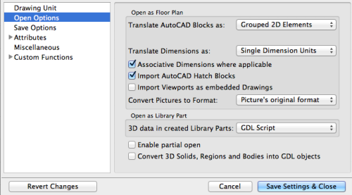

Open Options
These are options in the DXF/DWG Translation Setup dialog box.
  • AutoCAD Block translation with the additional option of including 3D Data in the resulting  Library Parts
  • The conversion of Dimensions
  • Import of Archicad Hatch Blocks
  • Conversion format of pictures contained in AutoCAD drawings
  • 3D Conversion when AutoCAD drawing is opened as Library Part
  • Filter, by layer, the elements to be converted into Archicad.
  • Opening as FloorPlan: TranslateAutoCADBlocks as:
    • 2D Elements
    • Grouped 2D Elements
    • Library Parts
  • Translate Dimensions As:
    • Lines and Text: you don‘t create a dimension out of the dimension entity; rather you use the drawing details stored in the file to get the same look (arrowheads, colors, text positions) as in AutoCAD.
    • Single Dimension Units: every dimension unit in the AutoCAD file gets converted into an  Archicad dimension unit. Note: dimensions may have different visual features in Archicad and AutoCAD. Not all of these visual features can be reproduced during conversion. The most significant difference is with arrowheads: Archicad has a fixed set of them, whereas in AutoCAD you can design your own set.
    • Dimension Chains: In AutoCAD, only separate 2-point dimensions are available (even though  there is a method of creating sets of dimensions that look like dimension chains.)
  • Associative Dimensions where applicable: In former versions of AutoCAD, dimensions were not associative the way we mean it in Archicad: that is, glued to hotspots of other elements. If you check this option the add-on will look for already imported elements to which to associate the processed dimension. It may be time-consuming, therefore the default behavior is to create hotspots on the element and associate the linear dimension to the hotspots.
  • Import AutoCAD Hatch Blocks: Check this box if you want AutoCAD fills transformed into unnamed groups of individual lines (hatch blocks). These will not be recognized as fill types in  Archicad. When importing a file from AutoCAD version R14 or later, hatches will be converted into fill types in Archicad.
  • Import Viewports as Embedded Drawings: Check this box to ensure that AutoCAD Viewpoints are imported as embedded Drawings after opening a DXF/DWG file in Archicad. If you uncheck the box, Viewports will be converted to Archicad views instead.
  • Convert Pictures to Format: Choose a file format to use in converting pictures
  • OpenasLibraryParts / 3DDataincreatedLibraryParts:
    • Binary 3D: store the 3D information in binary format,
    • GDL Script: store the 3D information in the GDL script.
If you process 3D data, the Binary 3D form is recommended: it is much quicker if the script doesn‘t have to be recompiled every time you generate the 3D view. The OpenObject command is the only way to get all the 3D data stored in a DXF/DWG  file!
  • Enable partial open
Check this box and save it as part of the Translator to filter, by layer, the elements of the DWG file to be opened/merged or XREF’d in Archicad. In this case, when you use File > Open or Merge on a DWG/DXF file, or when you Attach an XREF  file, the DWG/DXF Partial Open dialog box appears, listing the source file’s layer set and the layers’ status. Uncheck the layers which you do not wish to include in the Archicad project.
  • Convert 3D Solids, Regions, and Bodies into GDL objects
Check this box to convert the listed items into GDL objects upon opening the file in Archicad.

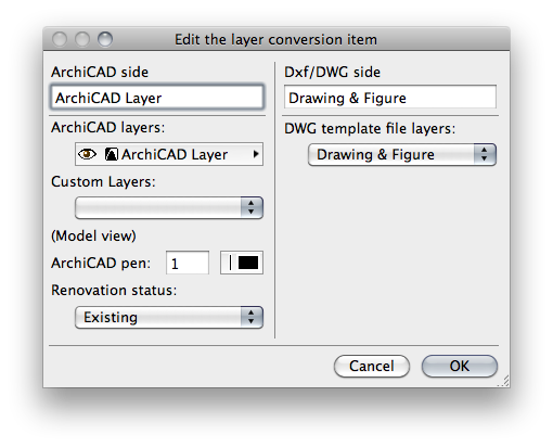

Layer name conversion
wp-content_uploads_archicadwiki_dwg-export-translator--editthelayerconvitembasedontempl.png
This table allows elements on particular Archicad layers or custom layers to be placed on a specified AutoCAD layer. If a template file has been specified in the Save Options then the target layers from that particular DWG can be selected from the drop-down menu.
wp-content_uploads_2016_06_Info_18x18.png NOTE: A problem may arise when you convert both “Exterior Walls” and “Interior Walls” to“WALLS” in AutoCAD. When converting wall layers back to Archicad, the dictionary will not distinguish between the two types of Archicad wall layers.

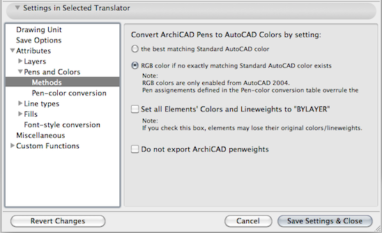

Pens and Colors
Archicad Pen Colors are configurable, while AutoCAD’s pen number association with colors cannot be modified. You can convert Archicad Pens to AutoCAD Colors by searching for the best color match or setting up a conversion dictionary.
Methods
Pen Methods match Archicad Pens to AutoCAD Colors
  • Convert Archicad Pens to AutoCAD colors by setting:- The best matching standard AutoCAD color. Every Archicad pen will be mapped to the AutoCAD color with the most similar color (RGB) components. - RGB color if no exactly matching AutoCAD color exists. While Archicad pens can be set to any color, AutoCAD has set pen colors that cannot be changed. In AutoCAD 2004 and later versions, it is possible to define further pen colors by specifying RGB values for them. These pens will have a pen index number of 256 or higher. If a color with the exact RGB value is not found then it is exported by the RGB value, with a pen index number higher than 256. This option is not available when exporting to DWG 2000 or 2002 formats.
  • Set all elements' colors and line weights to "BYLAYER": this option overrides the convert Archicad pens to AutoCAD colors option, and every saved element's color will be set to BYLAYER. When the AutoCAD user changes the color attached to a layer, everything on that layer will change its color accordingly.
  • Do not export Archicad pen weights: elements will be exported with line weights of 0.00 mm.
Pen-color conversion
Color pairs defined in the pen-color conversion dictionary will take precedence over the automatic conversion methods set in the Pen Methods. When exporting a DWG, Archicad pens will be mapped to the AutoCAD color with the most similar color (RGB) components, except where the pen is defined in the conversion table. This table pairs Archicad pens with AutoCAD colors. During export, the ID number of the pens will be converted according to this table. The pairs defined in the dictionary will take precedence over automatic conversion methods. The pen weights are not used during DWG export.

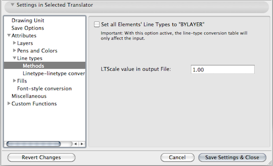

Line Types
Line weight is assigned to Pen attributes in Archicad as opposed to AutoCAD where each element can have its own line thickness value. When saving files, you can either set up a line type conversion table or choose to convert all Archicad line types to a single type in AutoCAD named BYLAYER. Note that symbol line types are stored differently in Archicad and in AutoCAD. Due to these differences, some of Archicad’s symbol line types will not look the same in AutoCAD.
Methods
  • Set all elements' line types to "BYLAYER": when this option is checked, every saved entity's line type will be set to BYLAYER. When the AutoCAD user changes the line type attached to a layer, everything on that layer will change its line type accordingly. Note that it overrides the effect of the Linetype-Linetype conversion dictionary.
  • LTScale value in the output file: The value of LTScale is related to the scale at which drawings are printed from AutoCAD, according to the scale of the drawing. Enter the default LTScale for the exported DWG.

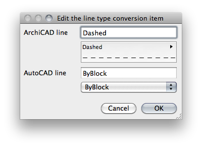

Linetype-to-linetype conversion
Symbol line types are stored differently in Archicad and in AutoCAD. Due to these differences, some of Archicad’s symbol line types won‘t look the same in AutoCAD. There are two solutions to this problem: - Redesign the problematic line type until the disturbing differences disappear. - Set up a template file containing an acceptable substitution for it. For more information on creating a custom line type in an exported DWG, see the Export Custom DWG Line Type article. The easiest way to set different Line weights as in Archicad is to assign line weights to layers or colors. To simplify the process in AutoCAD: - If objects require identical line weight by layers, check the Set All Elements' Colors To BYLAYER box in Translator Setup > Attributes > Pens and Colors > Methods tab. When you open the file in AutoCAD, you can set the line weight using the Layer settings dialog. - If you want to assign line weights to colors, save the DWG using Archicad colors. When you open the DWG in AutoCAD you can select the elements by color, and set the object line weight or you can create a Plot style table, which is a table that contains parameters used by printing/plotting. Here you can assign pen weights to the corresponding colors.

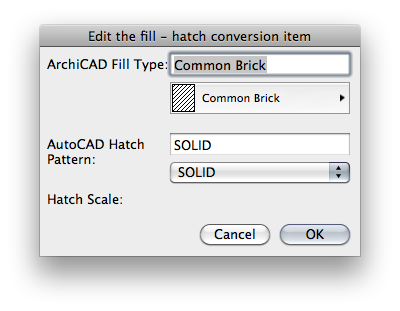

  • Use the fill conversion table: the conversion table on the next page of the translator will be used.
Fill-Hatch Conversion Table
From Archicad 12 the DWG translator can convert Archicad fills to specified AutoCAD hatch types. Create a new table row by pressing the "New" button.
This requires that a template file is specified in the Save Options and that the template file includes at least one placed instance of the desired hatch. The Archicad Fill Type can be selected from the drop-down menu, which will be converted into the AutoCAD Hatch pattern, which can be selected in the drop-down menu displaying hatches used in the template. Read more about Line and Fill Normalization

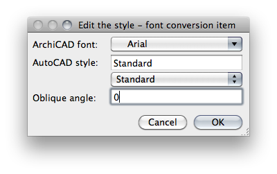

Font-Style Conversion
When an Archicad Project is saved as DXF/DWG, Texts in the resulting file may differ from the way they looked in Archicad. For example, the spacing of Texts may be different, so Texts block are not the same length or size. Furthermore, font names are stored differently in DXF/DWG files and in Archicad. Even when one-by-one font matching is possible, a dictionary is necessary. (On Windows, Archicad supports all available fonts including those installed by AutoCAD).
When exporting a DWG, if a text's font is listed in the dictionary, it will be converted according to the conversion table, from the Archicad style to the AutoCAD style. The Archicad font can be selected in the drop-down menu. The AutoCAD style can be selected from the drop-down list if a template file is specified in the Save Options. With the oblique angle option, you can set the degree value of the font. If the slant parameter is 15 (15 degrees) or greater, the exported text will be in italics. Usually, an italic style has an oblique angle of 75 degrees. Unless a template file is selected, the style will use the AutoCAD counterpart of the Archicad font. (A font conversion file specifies the best match, regardless of the platform Archicad is running on).
