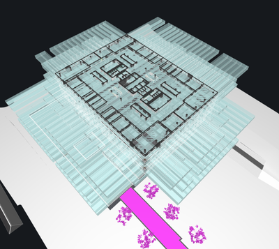

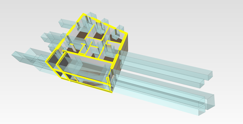

Hi, what is the reason that sometimes IfcOpenings (also from Doors and Windows) are getting ridiculous absurd dimensions?
This is a model I received ...
... and this is what I get with the same components.
I know for some time there is/was a problem for some time with automatically created openings but it's new for me to see this also on doors and windows. So I am wondering what is causing this behaviour? Is it a setting or a hidden option that's triggering this effect?

All those IFC files have been created by Archicad.
Screenshots are from IFC Viewers like Solibri, Desite or BimCollab.
No involvement of Revit. No import into Archicad.
It is an Archicad Export Issue.

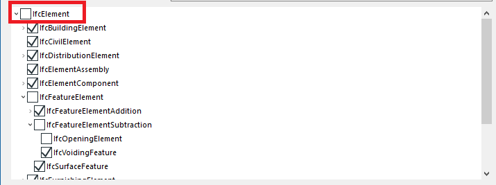

When you export IFC, into the translator, you must unflag the Ifc Opening Element. See the image attached.
