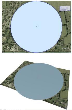

Folks I've created a Google Earth Object using the Google Earth Connections Add-on in AC12, but it seems to be a different size in the 3D window compared with the 2D window (see image).
Can anyone help me fix this object?

Either no one else has this problem or I'm in Coventry.
I contacted GSHu through my reseller, Applecore:
http://www.applecoredesigns.co.uk/
They suggested re-sizing the object -in the object dialogue- to fit the 2D image.
However I over-layed the survey which indicated that it was the 2D image that was too big so I amended the 2D script to match the object size from -
ADD2 -495.998, -371.998
DRAWINDEX 1
FILL 1
POLY2 4, 7, 0, 0, 991.996, 0, 991.996, 743.997, 0, 743.997 DRAWINDEX 50 PICTURE2 "GE Snapshot 3.jpg", 991.996, 743.997, 0

to
ADD2 -447.432, -336.683

And the object now behaves correctly. However I still don't know why or how this has happened so it's worth checking that 2D and 3D match.
