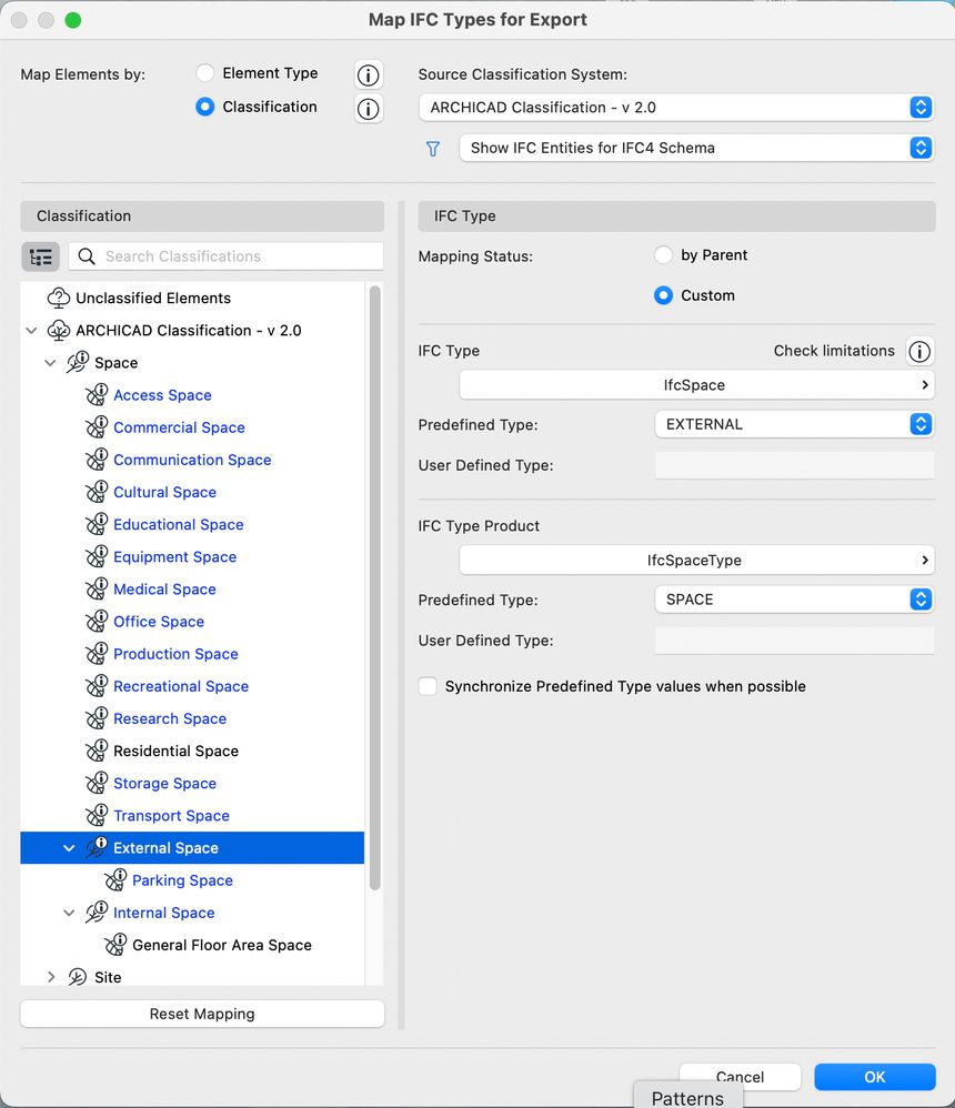

I am exporting several zones as ifcSpace
some spaces are landscape types, residential bedrooms, toilets, dining etc
how do I specify ifcSpaceTypes to catch all zones of type BEDROOM or all zones of type VEGETATION,
at present I can specify a Translator that ends up making all zones predefinedType BEDROOM with no other differentiation
tia

One approach is defining all required Space Types into your classification and expand the IFC mapping from there. You can use that to expand the User Defined Type values accordingly. This makes it part of your IFC translator.
Another alternative is doing this at the object level, in the IFC Project Manager or from the Zone Settings of a selected Zone. This is easier for smaller overrides, but the the IFC Translator in combination with expanded classification is probably the more robust approach.

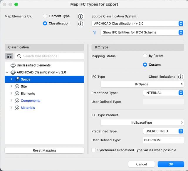

Hi Stefan
here is my Translator  IFC types for export settings
this causes all ifcSpaces to be of pdt = BEDROOM, eg
#640=IFCSPACE('1WdIHRts6bG9Vv5YLpOG4G',#2,'R03',$,$,#2030,#149,'Bathroom',.ELEMENT.,.INTERNAL.,$);
#727=IFCSPACE('0O$C6NAS1jHgbErheaa5ym',#2,'R01',$,$,#2675,#163,'Kitchen',.ELEMENT.,.INTERNAL.,$);
#730=IFCSPACE('2s$tiOQgoFIB7tQ$SZTMFg',#2,'R02',$,$,#2690,#165,'Living/Dining',.ELEMENT.,.INTERNAL.,$);
#19557=IFCSPACETYPE('07H_kqEGBtKlnXmYKpVV4j',#2,'Garden',$,$,$,$,'0747EBB4-3902-F752-FC61-C225337DF12D','BEDROOM',.USERDEFINED.,$);
#19645=IFCSPACETYPE('3LH2SGTg8K88W9ZSbyzjmU',#2,'Lawn',$,$,$,'D5442710-76A2-1420-8809-8DC97CF6DC1E','BEDROOM',.USERDEFINED.,$);
#19778=IFCSPACETYPE('0P3RcR$3cAZ81JH4bxcyYw',#2,'RESIDENTIAL GARAGE',$,$,$,$,'190DB99B-FC39-8A8C-8053-44497B9BC8BA','BEDROOM',.USERDEFINED.,$);
So, I'm unclear how to for example for all rooms in a residence specify any bedroom to be type "BEDROOM", any toilet, bathroom, shower type "SANITARY", etc. Hospitals have such classifications.
I also see that Ifc<element>Type in AC duplicates a lot of data, that presumably is supposed to make more efficient code?
Your suggestions very welcome

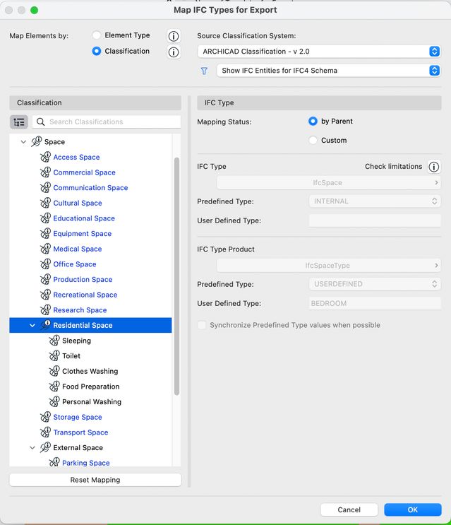

Do you still have the mapping for the "Space" classification, like your first screenshot in this thread shows?
If yes, then every classification below it will inherit the IFC Type and IFC Type Product mapping from it, because it is their parent (except the ones where a custom mapping is specified, like for "Residential Space" - in your second screenshot) .

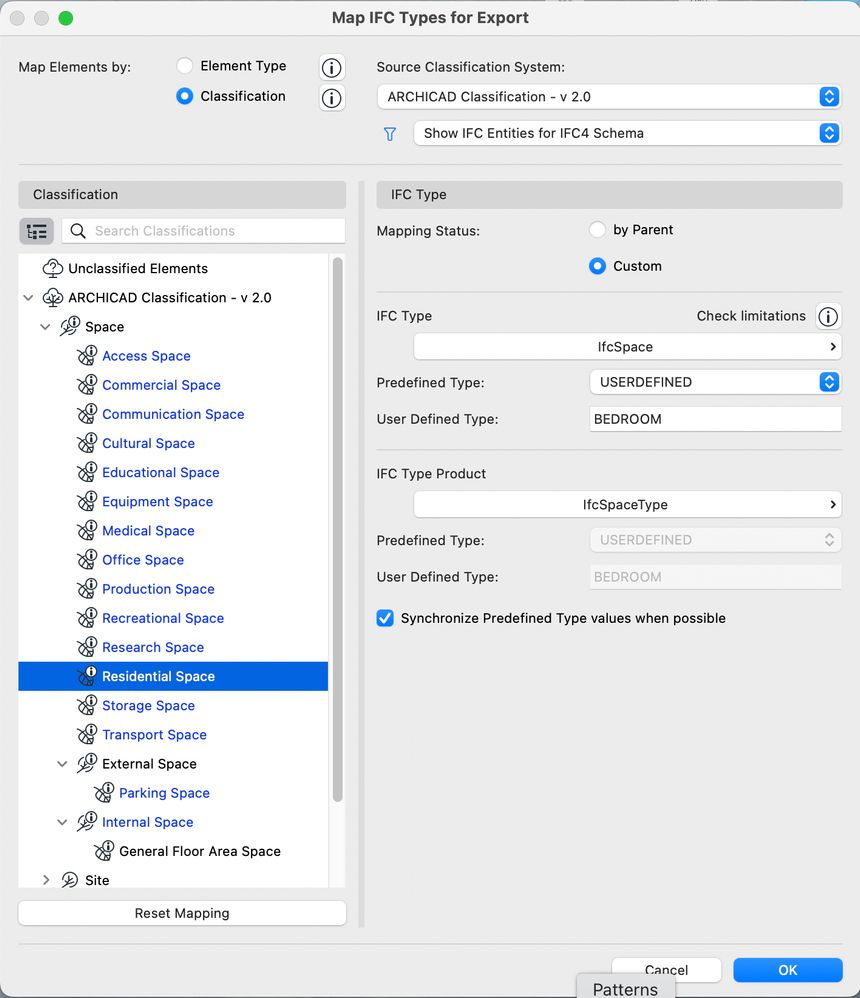

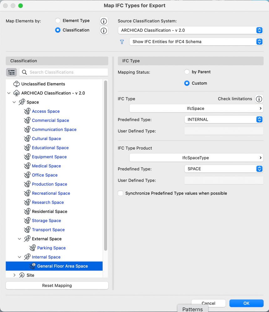

tks for all the feedback.
I have 3 "types" of spaces - external for vegetation water usage types, internal rooms and internal rooms of type "BEDROOM". I customised each (following your suggestions) and here are the settings in my Translator
and here is the IFC
#10565=IFCSPACE('3XSu3jajIWJOVDoaxdS8wW',#2,'R04',$,'BEDROOM',#95955,#877,'Bedroom',.ELEMENT.,.USERDEFINED.,$);
#10606=IFCSPACE('1WdIHRts6bG9Vv5YLpOG4G',#2,'R03',$,$,#95972,#885,'Bathroom',.ELEMENT.,.INTERNAL.,$);
#13497=IFCSPACE('2_9dsVe0RfIQsJO97EJJ4m',#2,'Front Lawn',$,$,#21623,#1374,'Front Lawn',.ELEMENT.,.EXTERNAL.,$);

So, does this work now?
What are the IFCSPACETYPE values now in the IFC file for these three elements?
You posted only the lines that show the IFCSPACE values, but not the lines that show the IFCSPACETYPE values.
Also, it makes it possibly confusing that you don't active the "Synchronize" option. This ensures that the space (IFC Type) and the space type (IFC Type Product) share the same predefined or user defined type.
