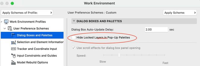

I just discovered, when I wanted to change a walls layer, that I somehow have pressed a button or something:
I have only three layers in the list... All the layers are still there when I enter the Layers-tool, why am I only seeing three?

Never mind. I found the "Lock/Unlock Layers Togle byutton 🙂

Never mind...again...when I press the above mentioned button, I get to see all of may layers, but they are locked...

Seeing only unlocked layers has been an option in Archicad for over 20 years.  You must have the checkbox shown here checked.  If you want to be able to always see all layers, just uncheck that box in your Work Environment settings.
