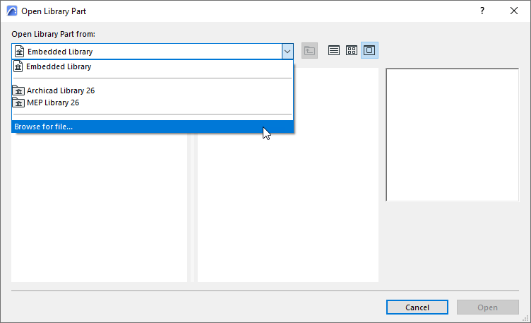

You do not have to load the DWG into a Linked Library or the Embedded Library.
When you use the Open Object command, at the top, you will have the "Browse for File" option. Use that to select the DWG file from your file system.

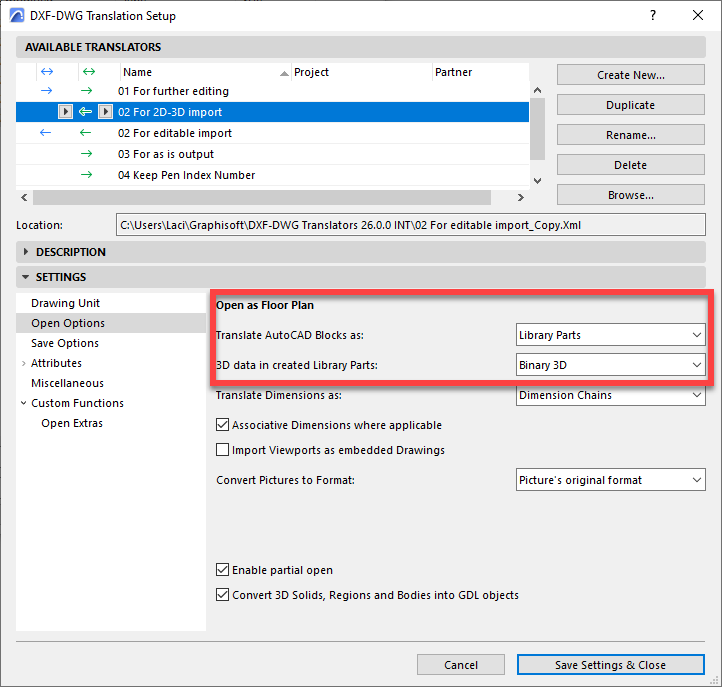

Also, it appears to me that the default DWG Translator used for import will not bring in 3D data.
So, make sure that you create such a DWG Translator (if no such translator exists, my Ac26 INT does not have one of these) and use that when opening the DWG file as Object.
Here is the important Open setting you need to set in the DWG Translator:
I have not tried these settings because I do not have a 3D DWG file, but hopefully these are the settings that will make this work.
Let me know how it went.

Thanks to share this information. The settings that Laszlo gave, work.
Many thanks Laszlo.
