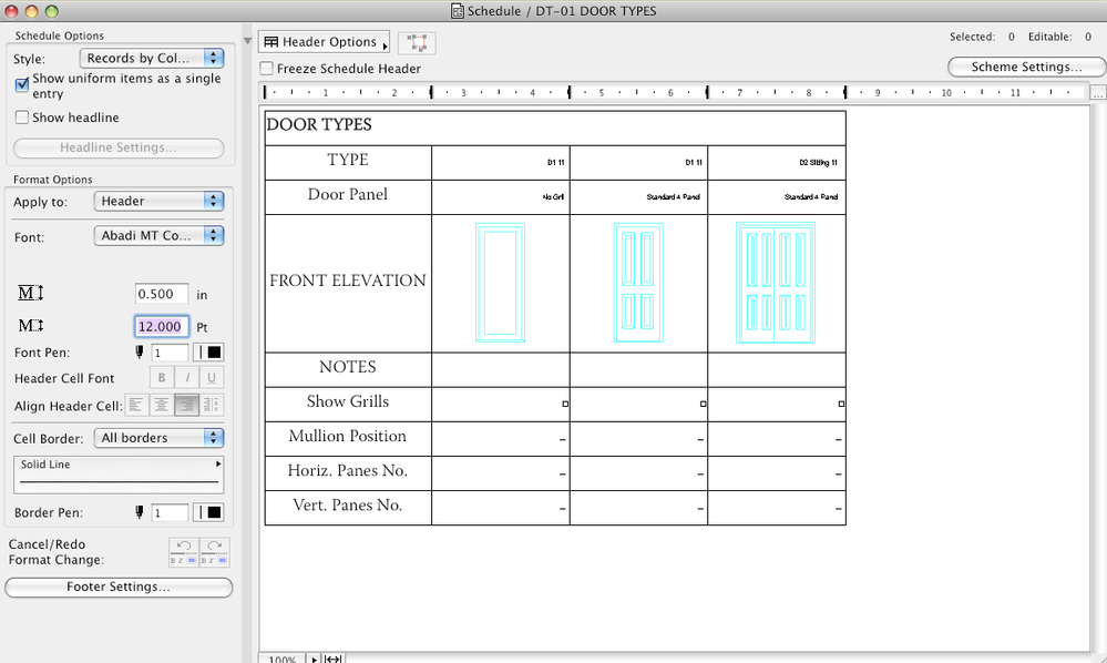

Kees, I'm not sure how you could make the argument that CadImage DWB schedules are "better" than homemade AC11 door/window Interactive schedules if you have not used the latter.Chazz,
I have to support Kees here, simple because the current IS can not do properly what DWB can, and that is - drawn schedules. I would say this is the major drawback of IS at the moment.
Yes, DWB schedule is not biderectional, however it does deliver as oppose to IS which is a nice idea (talking about scheduling in general) however it is utterly useless in terms of opening schedules.
AFAIK, the drawn D/W schedule is essential for (at least) Scandinavians, AUS, NZ and UK.
Talking about DWB - I have stopped using it because of the problems with new versions of AC. Also, whilst appreciating Cadimage efforts to 'fill the gap' I do not like their ruthless approach towards a smooth AC integration, creating dummy layers, attributes, fixed folders etc. I think they are putting too much 'creativity' into it resulting in a bloody mess and problems with upgrades. They should really keep a low profile with AC resources handling and integrate DBW without interfering too much.

Rob wrote:I sense an Australian conspericy brewing here, the southern hemisphereians ganging up on us poor yanks with brains addled from reading too many election/political blogs. ....
Chazz, I have to support Kees here, simple because the current IS can not do properly what DWB can, and that is - drawn schedules. I would say this is the major drawback of IS at the moment.
As I'm sure you know, the Interactive Scheduler absolutely will do drawn opening schedules (if by that you mean elevational views of the openings). No, it will not dimension the openings but it does give you a picture and the proverbial 1000 words. For me, the convenience of keeping my schedules live and bidirectionally editable is worth the cost of losing the dimension strings which, given that the sizes are already provided in the table, is mostly redundantly redundant. Yes, it's nice when grids, muntins, mullions, transoms, handsets, etc are dimensioned separately.
I agree that IS could be better but what I really want is DWB to work better with IS.

THIS is why we need a better DWB INSIDE AC!!!I think this is the essence of DWB blunder.
You can not make a successful add-on without a proper integration into the main engine and eventually all little odds and sods will mount up and they become a major issue with upgrading as it is now...
I sense an Australian conspericy brewing here, the southern hemisphereians ganging up on us poor yanks with brains addled from reading too many election/political blogs. .Oh, don't start... your silly election campaigns take at least 10 minutes of everyday news... as the most famous American says - booooring, where are my donuts?...
As I'm sure you know, the Interactive Scheduler absolutely will do drawn opening schedules (if by that you mean elevational views of the openings). No, it will not dimension the openings but it does give you a picture and the proverbial 1000 words. For me, the convenience of keeping my schedules live and bidirectionally editable is worth the cost of losing the dimension strings which, given that the sizes are already provided in the table, is mostly redundantly redundant. Yes, it's nice when grids, muntins, mullions, transoms, handsets, etc are dimensioned separately.apart from all of this we need to show dimensioned sills for windows. Also, another shortcoming of IS is that it will list all openings separately, so if you had a window as a composite of different library parts (eg complicated shape etc) you're stuffed as it will not be listed under one opening. (as oppose DWB that allows you to designs really complicated geometries)
However, this goes into questions about the obsolete design of openings creation relying on sort of one-off GDL lib part.... but that is a different cup of tea.
::rk
