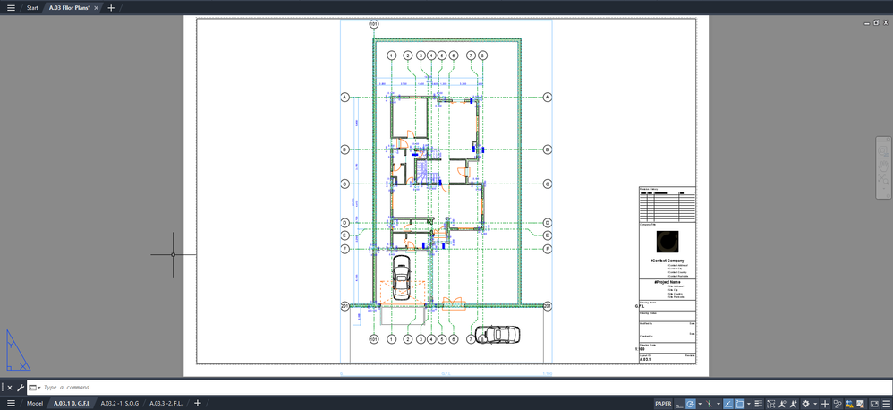

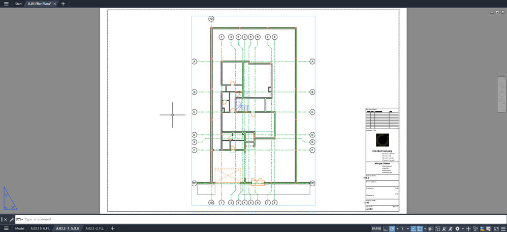

Here's my workflow reinforced by screenshots, hope that helps.
1) Archicad (27) floor plans in view map.
2) Archicad (27) floor plans in layouts.
3) AutoCAD (2024 LT) floor plans in Model tab.
4) AutoCAD (2024 LT) floor plans in layout tab.

HI Mahmoud.
Thanks for the screen shots - I've tried it with a new file and it seems to work!
My issue with the other files was the way they were set up. The plans on the layouts were 'embedded' rather than originating from a view - there were no views in the View map.
This meant there was nothing to save in the model space.
I think I've got a way of dealing with this - So, Thanks again.
