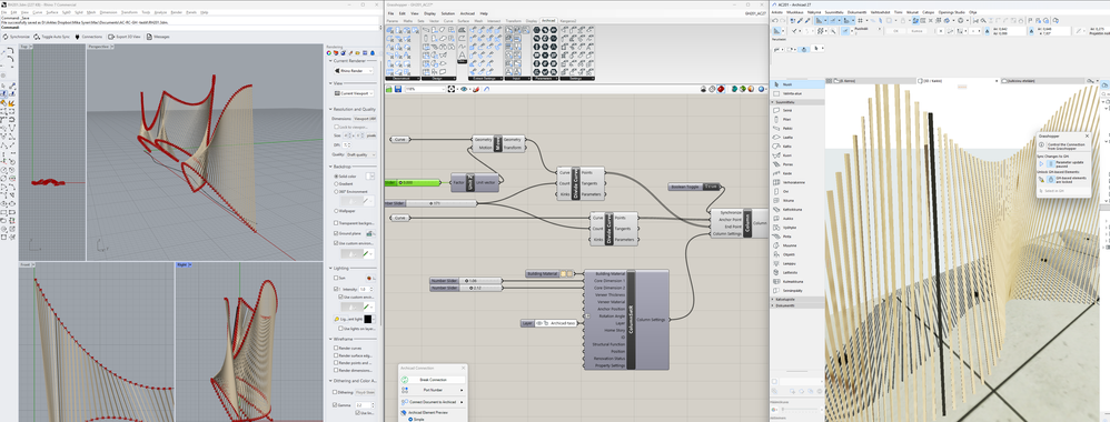

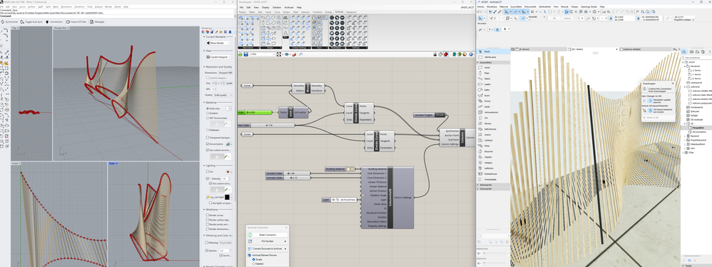

Can't say it's fully bidirectional, maybe only in some aspects. GH generated elements are locked by default in AC. You can open the lock status and change things of the unlocked elements in AC. Thay will change.
If you then go and edit GH definitons of those said elements in GH again, and live link does it's job, it will over ride what needs to be overriden. You can have a material change for example go through, but the geometry will be straightened out according to GH maths and rules. Your change of for example column tilt angle won't stay there. Your change in AC geometry versus that of GH mathematical rules will contradict. GH wins here if the link is active still.
I am a pure novice with this, sorry, but just tried that one out mentioned above, out of curiosity. Changed tilt, changed material. Then upped column count 5 pcs. Link made it's thing, material intact, column in new position according to GH rules.
You can have input from ArchiCAD though, it's not that there isn't any bidirectionality at all. Just in terms of what is possible. And you deconstruct AC elements and make use of those sub-data types.
Kind of a Chicken and Egg problem I think, something like that maybe, I don't know? You can't make an arithmetical/algorhitmical definition, transform it to ArchiCAD objects and geometry, then change it in AC and hope it to transform back to Grasshopper as an algorithm and definitions.
I really wish I had more time with. I do think this could be a life saver for ArchiCAD in the long run. You can't replace this for one of your own developed tools quickly enough. ParamO seems fine for simple tasks, thanks for that too. But GH connection being there, it's not that big of an interested, at least to me it's not.
I do realize a lot of quoestions that do arise using the AC-GH link are related to Rhino/Grasshopper more than ArchiCAD itself. Maybe this cross-operation of GH-AC is without a dedicated channel right now, and I understand why that is. It's related to Rhino, Grashopper and ArchiCAD, all three of them. It's just that you probably don't know exactly what's the proper forum to ask your question on.
