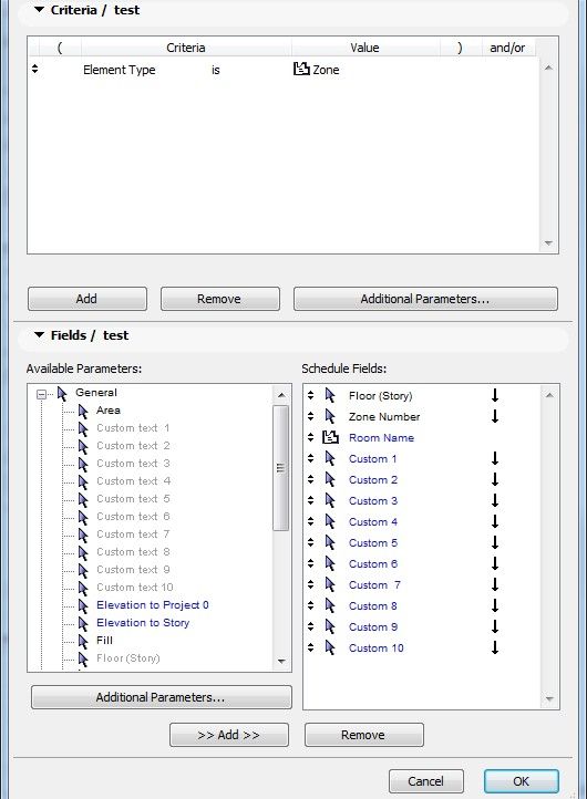

Here's a screenshot of a schedule with 10 custom fields (and little else actually).

John, it looks like you're scheduling doors, not zones, but I still have 10 custom fields available.
Just opened v.11 and yes, there are only 3 custom fields. Looks like the old door parts were written that way and unless you want to open them up and customise them, that's probably how it will have to be. Either that, or it's $$$ to upgrade.

I think that I've discovered how to add more custom columns (fields) to the door and window schedules in ArchiCAD 11. Here is what worked for me.
1) open the DOOR SCHEDULE from the Project Map.
2) open Scheme Settings in the upper right corner.
3) open Additional Parameters in the lower right corner.
4) in the Additional Object Parameter window change the view to Folder View (Used Objects Only).
5) expand the list: ArchiCAD Library 11 list/Object Library 11.lcf/Doors 11/Wood-Plastic Doors 11/Wood Internal Doors
6) select D1 11.gsm (this door is common in this project)
7) scroll down the Available Parameters list until you get to the User Defined parameters (there were 8 additional user defined parameters available)
8 ) add as many User Defined parameters as you want
9) click OK to accept the additional parameters
10) adjust the order of the Schedule Fields
11) click OK to accept the customization of the Scheme Settings
12) rename the column titles
13) add text in the column cells as needed
14) adjust the width of the columns
15) adjust the width of the schedule to fit on the sheet
16) drag the DOOR SCHEDULE from the Project Map to the desired layout
17) make any adjustments needed to the schedule in the Scheme Settings view and update on the schedule in the layout view
18 ) repeat for the Window Schedule
