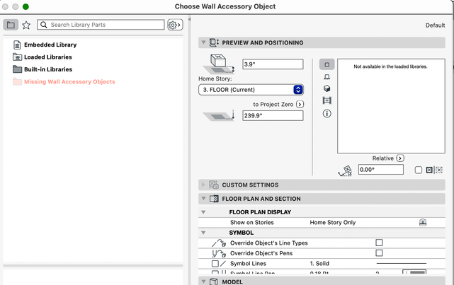

hi! we have archicad goodies and I have it's library loaded in library manager. For some reason however I can't find a way to use it... as it shows absolutely nothing in library but I tripled check and it is loaded, saying "missing wall accessory objects" .

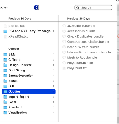

yes! adding now! 🙂 so... I just added the "library folder" recently.. not sure how to additionally add the "accessories library pack" - it is already installed, Could you helppp please?

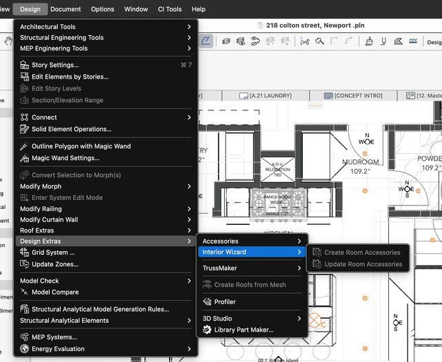

I followed this manual https://graphisoft.com/us/downloads/goodies which says only to instal and how it would run automatically... it loads in menu under "design" some of its part but when I choose to add stuff, it shows nothing in library so I thought adding it in library would do the trick but nope. not sure what to do
