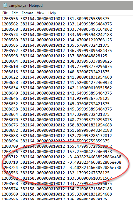

There is no "standard" for XYZ data, it's more or less just an ad-hoc solution, and everybody does as they please.
Regarding Archicad: It's quite picky...
First of all, it's okay to have mixed data. If Archicad finds any non-numerical input the whole line will be discarded as a comment.
Also it is okay to have a numerical IDs for each row (making 1+3 columns).
Just be sure that every row has the same number of columns. The seperator also needs to be the same. Allowed seperators are Space, Tab, Semicolon (;). Also Periods (.) and Commas (,) are accepted, but I highly discourage their use because they will get confused for a decimal seperator easily by humans.
And of course there must not be any missing data.
This and wrong seperators I found to be the most common cause of mishaps.

I had the same problem last week and got X Y Z listings to work - with the help of our Australian distributor. Mine didn't work for the following reasons:
1. my surveyors list included a first column which numbered each data point. AC won't work if this column exists and I had to delete it.. The first column must be X.
2.  each data row has to have X, Y, and Z. My surveyor's list omitted some 'Z' entries (because they represented fences and non-point data items. I had to delete each row with empty 'z' spaces.
3. Some X Y Z tables can't cope with a heading row, if they do, the column names have to contain X, Y or Z.
I enquired from Graphisoft if they had defined rules for X Y Z tables but they haven't. I also asked an ex-university surveying lecturer friend if the surveying profession had national or international standards for the layout of these tables but they have not.

thank you all for your replies - much appreciated. I opened several test files in notepad and after deleting all entry lines with "other" separators [attached] the files imported into AC just fine.
In all candor this is over my head, but happy to have a work around. Now I need to revisit the QGIS file generation sequence and figure out how I've given it poor instructions......'cause with me, it's almost always pilot error. ;-]
