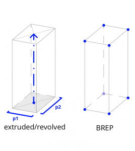

Native ARCHICAD elements can be carried as both Extruded/Revolved and BREP (Boundary Representation) geometry. We choose this depending on the disciplines, we send our model to. What is the difference between these two? Extruded/Revolved elements are parametric, their geometry is based on vectors and profiles, rotated around an axis or extruded by a specified distance normal, for example ARCHICADs Wall, Beam or Column elements. On the other hand Boundary Representation elements are build up by nodes and faces, similar to how our Morph elements are. [su_spacer size="1"]What should we export? The exported IFC file should depend on the discipline we send it to. In a simple scenario: Extruded/revolved: From a structural engineers point of view finishes, doors, windows are probably irrelevant, but they could use other parts of the model (columns, beams, slabs, walls with openings, footing etc.) as extruded elements, for structural analysis and calculations. BREP: MEP engineers wouldn't benefit from extruded/revolved elements, what they need is the exact geometry. (Note: Usually the structural engineers use the architects structural model as a reference, but model the geometry in their own environment. Such a scenario but be better supported by exchanging BREP geometries.) Where can we set this? Read more about how to set up the Geometry conversion for IFC Translators. [su_divider top="no" size="1" margin="10"]

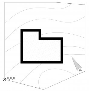

Local CoordinatesModelling in Local coordinates means that we are close to the Project Origin and our model isn't rotated to North. This is the easiest, most common and the recommended workflow for architects.[su_spacer size="1"]

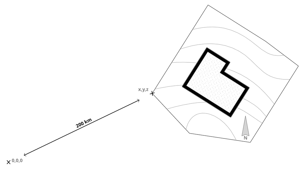

World CoordinatesModelling in Real World Coordinates means to place the model where and how it would stand in real life. In this case, the origin is a defined point with an x,y and z value and the model receives it's coordinates based on this reference, rotated to it's true north[su_spacer size="1"]

Starting from AC20, in the Object Library there is an object called the Survey Point Object. It was developed to support the workflow of modelling at local coordinates. Instead of placing the model far from origin, we can place the Survey Point Object where the 0,0,0 of the exported file should be. Look for the related Settings under File/Interoperability/IFC/IFC Translators. [su_divider top="no" size="1" margin="10"]
