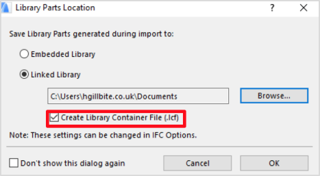

  • Create a .lcf (if the IFC Model contains objects)

  • Do not store Library Parts in the Embedded Library, especially for Teamwork projects. Adding hundreds of .gsm files to the Embedded Library can cause Teamwork performance issues.
