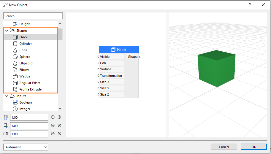

  • Some of the nodes are basic shapes such as block, sphere, cylinder, wedge, and so on. To create a simple block object, for example, simply double-click or drag and drop the Block node from the editor. Scroll through the nodes or type what you're looking for in the search bar. The new node appears on the canvas, and the 3D preview is updated automatically.

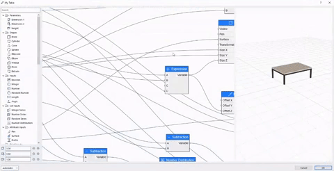

Table
Learn how to use the three main parameters (x, y, z). These three parameters can be modified using the object's hotspots in 2D and 3D, and in the object's settings dialog.
