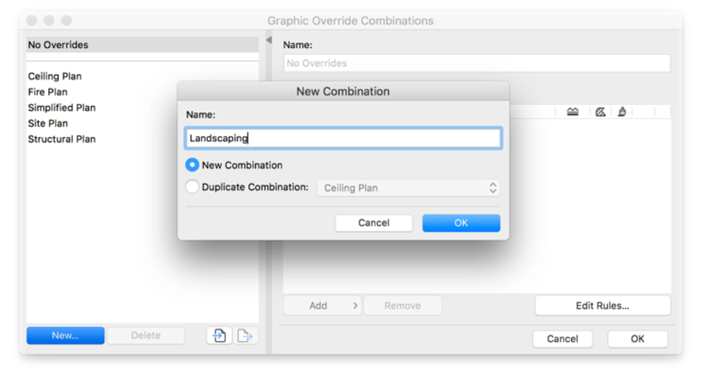

After selecting the mesh and converting it into individual roof plans, we are ready to create a Graphic Override combining customized rules. To create a new Graphic Override combination, go to Documents/Graphic Override/Graphic Override Combinations, click New and name it as Landscaping, for example. Choose the Edit Rules… button and set the rules to color each roof element with different slope angle with a different color. For example, the roofs elements that have the slope angle less then 6% will have its fill surface overridden with a red color pen and its 3D surface will be overridden with a red paint surface. Let’s do a new rule for each range of slope angle 6-12%, 12-20% and so on with different overridden color each.
Add all these created rules to the new Graphic Override combination as shown below.

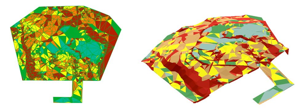

Now go back to the model and apply the new Graphic Override combination on both 2D and 3D view. That should be the result:
It becomes very clear now where the steep areas of this site are.
