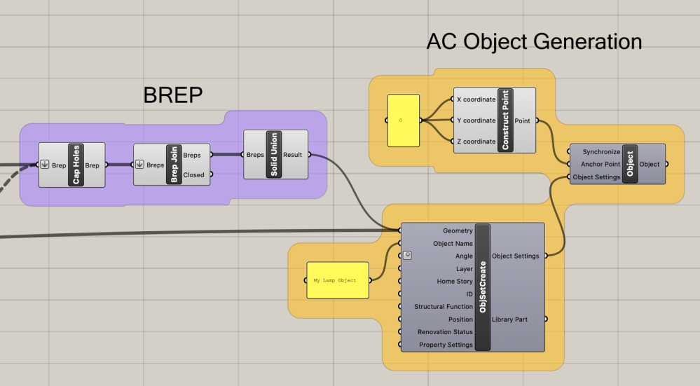

Here is an overview of the Grasshopper script: the base legs and the jittering connecting pieces are in two groups and there are some input fields available for editing both. Additionally there is a BREP group (more details on this below) and the conversion to Archicad Objects in the end.
1., Once the geometry (base and connectors) is created place the Archicad/Settings/Object Settings and Archicad/Design/Object components in Grasshopper.

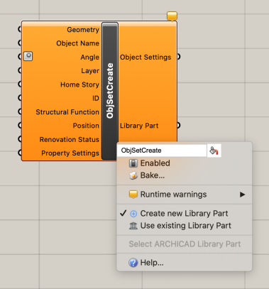

2., Right-click on the Object Settings and set Create new Library Part and connect the relevant nodes.
3., Add a Panel component and specify the name of the final Library Part (Object Name node).
4., Add a Point for the anchor to the Object component.
Now the geometry script is almost ready to be connected to the Object Settings through the Geometry node. If you link them at this stage, all geometry pieces will end up as individual objects. To prevent this, create a BREP from all the pieces (in this example the base legs and the connectors) and connect that unified BREP into the Object Settings.
