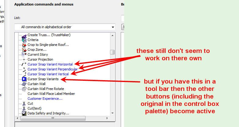

I noticed in the 15 Work Environment that there are 'new' commands for the cursor snap variants.
These still don't work on there own but if you add in the 'Cursor Snap Variants' control then these will become active when you press that (see image in next post).
I also noticed there is a shortcut 'SHIFT+Q' that can be used instead of setting up a new toolbar.
So instead of just "SHIFT' press 'SHIFT+Q' and you will be able to select the snap variant you want.
Or just keep pressing 'SHIFT+Q' and it will cycle through all 3 variants.

Thank you for the detailed reply- you rock sir! The Shift Q works just fine and is probably the easiest solution.
