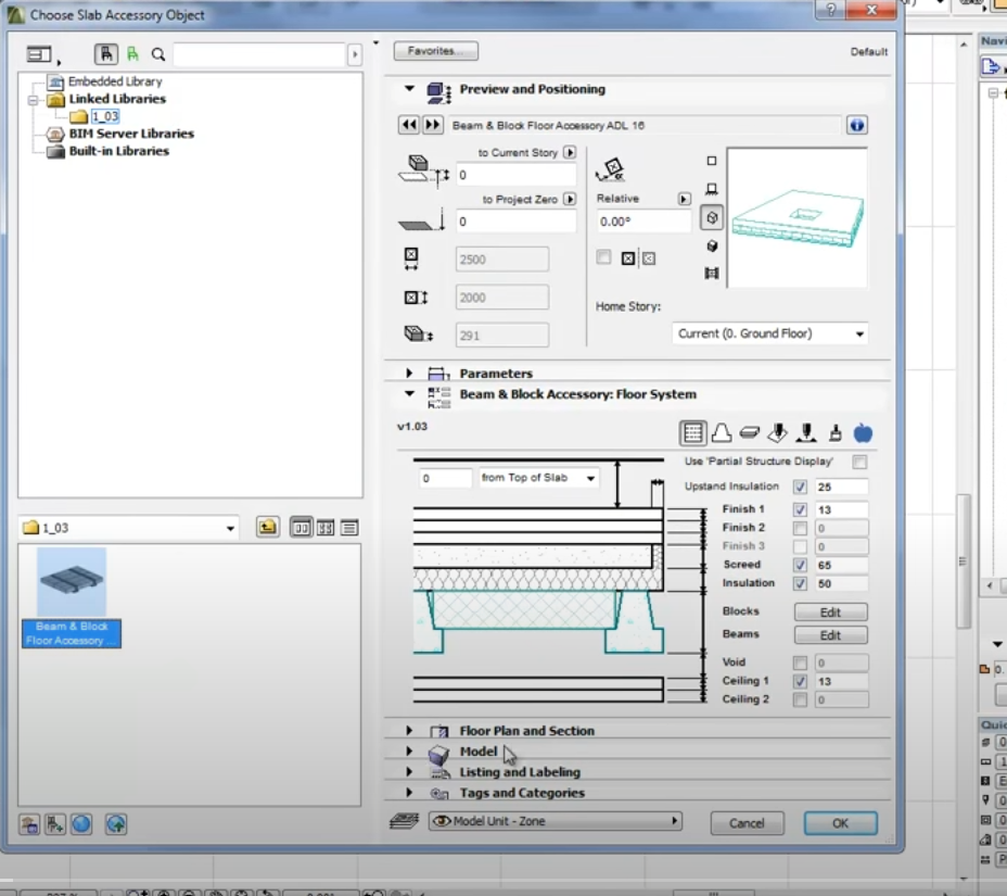

Hello All,
I've been researching the internet (and this forum) about modelling a Beam & Blocks slab (aka Ribs&blocks).
I couldn't find any solution that wouldn't require extensive modelling and seo's, except an accessory released in it's time by Applecore.
Since Applecore has stopped it's operations, this accessory is not available anymore.
So my question is : does anyone have it ? or any other solution for modelling such slabs ?
Best regards
Paul

Hello Paulbxl,
I use to model this kind of slab with morph tool, like this example I have done last year (cloud to model) :
Beam and blocks slab
Is not a full satisafying solution but it works quite well.

Look at the question above dealing with use of beams and slabs. You can probably get more control using that approach

Ok guys, thanks for your input.
I actually got the GSM slab extra from graphisoft UK, and it works like a charm.
Simply email them at support@graphisoft.co.uk and they will send it to you.
