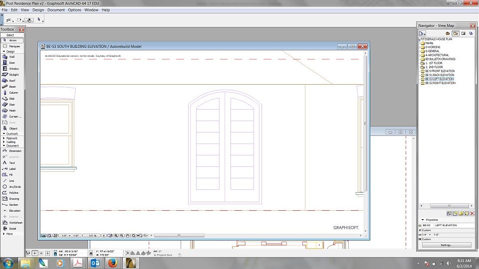

Ok so I still got it to save but it comes in all wrong and not at all like what I drew. Any expert want to save it for me?

Despite saving it as a window file and making it out of slabs, when placed its and object, basically looks as if I drew it out of lines, doesn't insert into walls or anything.
Eduardo Rolon
There are some newbie errors but the main one is that you assigned the ID "WALLHOLE" to all the slabs. The Help Center instructions indicate that after you draw the window or door with slabs and walls, then create a NEW slab with the window/door shape and assign the "WALLHOLE" ID to that one
http://helpcenter.graphisoft.com/guides/archicad-17-int-reference-guide/virtual-building/parametric-...
2.
Using the Slab or Roof tool, create another element whose contour matches the outer contour of the desired wall hole or wall niche.
Since you assigned Wallhole to all the Slabs AC was creating an object that is invisible.

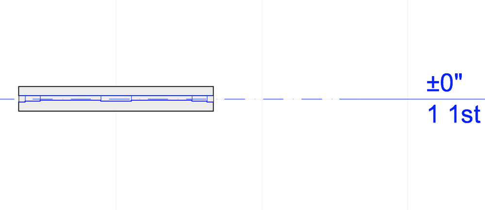

Also to align the window to the middle of the wall you should align the elements in section to match what is needed. If the wall is 8" deep then the wallhole slab should be 8" also and the position of the other elements should be in the center of the wall (see other screenshot) This might be unnecessary but that is the way I am used to doing it.

Eduardo Rolon
section view and link to the file on Dropbox which I will remove later
https://dl.dropboxusercontent.com/u/1715445/2014-06-02%20Window%20FILE.pln
