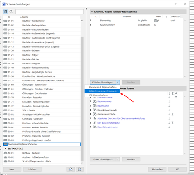

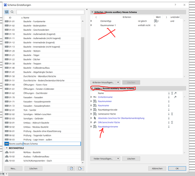

I'm trying to create a schedule with zones that belong only to one schedule. Therefore, I'm trying to filter them by that paramenter. The problem is that this parameter can be found only in the "fields" section of the schedule settings, and not in the criteria section:
Just the same I can't find the necessary parameter if I use library parameters options
Is there a way to do what I'm intending to do?

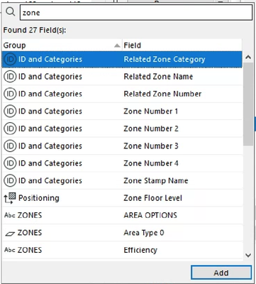

Firstly, here is the difference between listing zone category as a criteria, versus as a field:
  • CRITERIA
    Add zone category code as a criteria if you want to filter out and include in your schedule only the areas belonging to a particular zone category
  • FIELD
    Add zone category as a field if you want to include all zone categories, but break down the areas in the schedule according to each zone category
Also, to answer your question - you should be able to add zone category as a criteria. Here is what it looks like in the english version of Archicad

Thank you! That was the translation problem, after all then). The thing is in German version instead of "Raum Kategorie" the criteria is called "Zubehörige Raum- und Flächennutzung" which means literally "Related space and area use". However otherwise it's called "Raum Kategorie"
