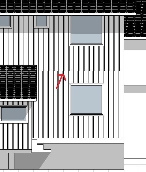

How do I correct the texture glitch at the Arrow in the Picture? I Guess it has something to do With wether I Draw clockwise, or Counter-clockwise, but how do I correct it?

While in the 3D window go to Design Menu -> Align 3D Texture and select were you need the texture to start from.
Thnx!
That did the trick.

I've found it helps if you check that the wall direction of both lower and upper storey walls are the same. Turn on "Wall and Beams reference lines" in View > On Screen View Options menu.
