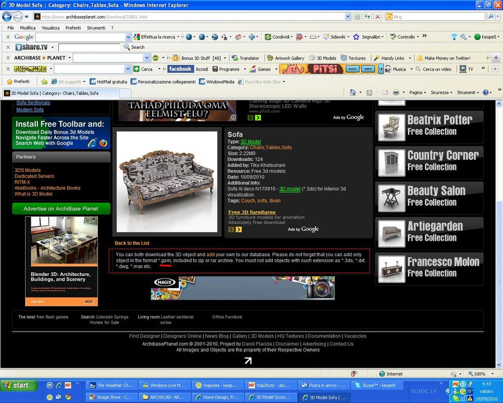

I wanted to say that sometime I downloaded some image 3D or other from www.Archibaseplanet.com in format .gsm
Before I asked if is possible to convert Images .jpg, ,jmb or .tiff in Image .gsm because I would like to add to my ArchiCAD Library Parts some pictures of furnitures that I take with my photo camera or from some web site, so I can make a project with the wished furniture.
May be you can recommend me another sistem.
I am an University Student at the last year (Interior Design) and I would like to put the best images in my degree examination.
Thank you for you help.
