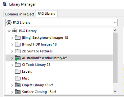

I've been wondering what is the meaning of the dark grey colouring of some folders in the Library Manager window?

As for the folders, they are all Library Container Folders (LCF).
You can access the objects as individual objects but can't edit them (the scripts) unless you extract them.
On your system they will appear as a single file (like a ZIP file).
I assume that is why they appear different to a standard folder that you can browse into.
