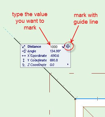

Or you could use the measure tool to mark the distance.
"M" for measure, click the start point, type in the distance and press the little "mark position" icon.
This will place a guide line and circle at the location you want.
Now just drag the wall there.

Wheres the mark position icon Barry?
When the tracker is active you type in the figure you want to mark - can be distance, angle x, or y.
Then you will see the 'mark' icon.
Pressing this will add a guideline for that measurement.
