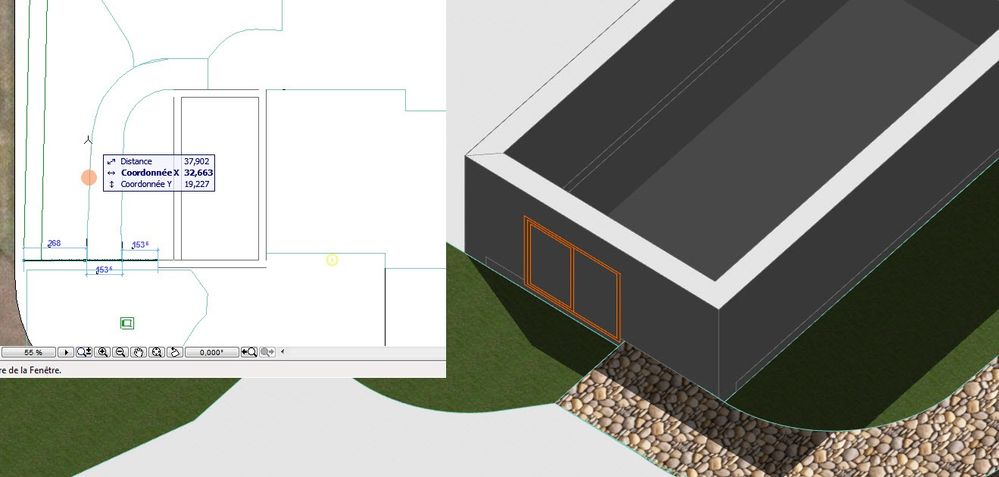

Hello again,
I put one picture so you will be able to understand my problem, first i put a window on my wall and it doesnt show the symbol of the window and i look in 3dview i can see the window.
Do you pls have solution to solved that problem.
Thank you verry much for answering me.

It looks like you may have more than one wall in the same position? Perhaps try deleting one to see if that's the case?

No , i deleted and no there not too wall, Thank you for answering me, but i be happy if you can make me other hint.
Cheer
Thank you , you where right , i have make a mistake on
my level stair this is why i have two walls , again thks

No worries. Another telltale sign apart from the window in 3D not appearing correctly is the walls are not healing correctly in plan.

Hello Again,
My problem restart this time it is not the level as i mentioned earlier , my window is not enough large i think , you can see in the cutting view the whiteness . My plan view the Windows do not appear again.
If you have any idea you can suggest me it would be great.

Change the wall's floor plan setting to "Symbolic Cut".

Thank you for your answer but i cant find that setting in the french software maybe pls you could start at the principal menu so i can match this thing.
Forget my last email i found it, thank you for your good support
