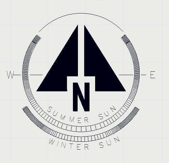

Is there a north arrow that would show the Sun gradient in the summer and winter based on the site coordinates. Like the image posted.

Cadimage have an object that can sit on the outside of your North Compass: Daylight Angle Marker #1544: https://bimcomponents.com/GSM/Details/17712
Thank you for the reply. Unfortunately, like the others that have commented on the BIM Components site, I cannot download the file.

Yes for me, I just downloaded and Embedded object. Then moved it to my Custom Library. Thanks for alerting me of the object, now the "beggar" is wishing it was more interactive with the Project settings. Even if it was date specific and noted the date in the stamp. Either way it may become my new arrow.
