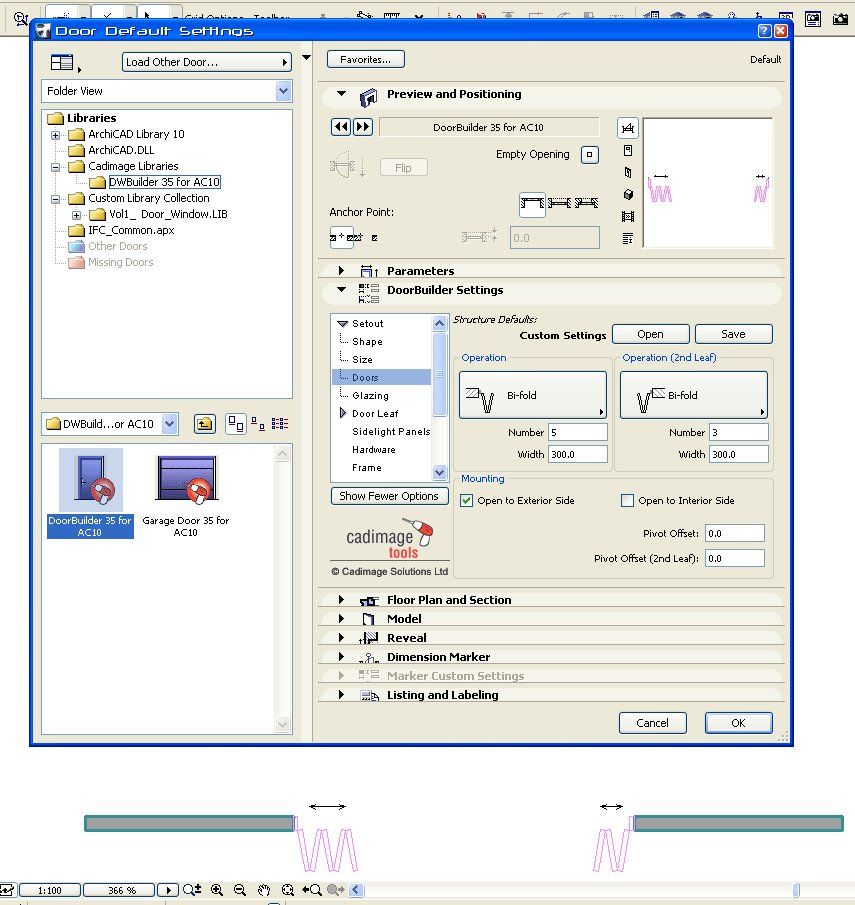

Ok, I found a copy of door and window builder on our server, and loaded the library on my machine, So I set up an accordion door with three panels, but the 2d symbol won't display correctly, which means it isn't going to show up in my schedule which is the whole point of doing the door this way.
I keep getting a script error whnever I turn the symbol on
any suggestions
That looks like a pretty old version of DWB (2.01), perhaps belongs with AC6 or 7 maybe. There would be compatability issues with AC10. Not even sure if you'd be able to upgrade that, as it was probably pre-Cadimage days, but you could try.
