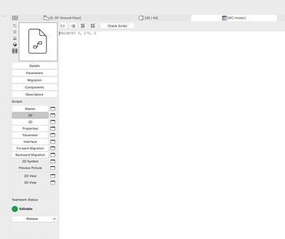

Hello Florian99,
Just delete "2D Script" and draw your own 2D symbol into "2D Symbol" tab.
Or try to delete "2D Script" and write this...
PROJECT2 3,270,1
projection_code
the azimuth angle set in the 3D Projection Settings dialog box
"style" 1: wireframe, 2: hidden lines (analytic), 3: shading
To get few 2D symbols about one object I am able to help you to understand and get your aim.
