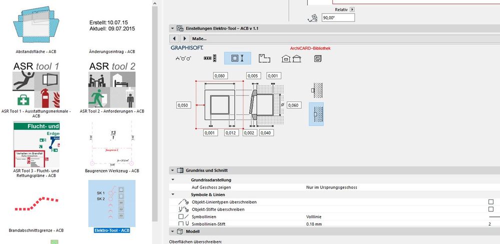

Frank Harper
The German Subscription Service ArchicaRd offers smart gdl sockets and light switches to add into the library. acb.JPG
