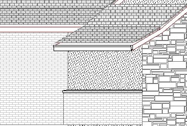

I have attached an image to show what my problem is. In the image you will see that the roofing materials do not follow the slope of the roof all the way to the eave. I created the roof materials using the "Extras | Accessories | Roof Accessories" tool. I played with most of the settings and have searched the ArchiCAD help files and the forums and cannot seem to find a way to have the roofing materials follow the slope properly.
Another question is there a tool within ArchiCAD that will allow me to create an eave detail that follows the rake of the gable ends? I have uses "profiler" to create eaves on horizontal areas.

I have had moderate success w/the roof surfacer tool. It does seem a bit cumbersome. I'm not sure why it's not following your roof surface - I couldn't tell from the image you posted, but does your roof change pitch? While I don't have AC open at the moment to test, I think there was a parameter in the roof surfacer object (once placed) to adjust how far above the roof it is placed - maybe that's what you're looking for? If all you're after is to get the shingles to show in elevation view, it's much easier to just apply the shingles hatch to a roof plane instead of messing w/the surfacer. I usually create a 1/2" thick roof (like the plywood sheathing) and over hang it 1" or so over my facia for a little shadow line - that's the roof I apply the hatch to. I usually only use the roof surfacer on metal roofs when I need to model a corrugated roof or similar. Sorry for the rambling - it's saturday and my "work" mind has shut down to allow my "mow the lawn" mind to get going. Facias are a long standing issue w/AC. There are many ways to deal - slabs, roofs, profiler, archiforma etc... That is something that AC could really use some help with.

Thanks for the post on a "non-work day" I removed all of the roof surfacer fills and did the hatching like you suggested and liked the results. I looked around for a way of creating
and could not see a way of doing that. The roof tool, as far as I could see does not have a way of defining a thickness. If you have a chance would you please post a bit of direction on how to do this. It is exactly what I want to do with this project.

You can set the thickness of a roof just like walls and slabs - I don't have AC open in front of me now, but I copied a section from the (gasp) manual for you. You can set the roof plane's thickness either vertically or perpendicularly. Even though the option seems grayed out in the manual - as long as you're not using a composite roof, they will be editable.
