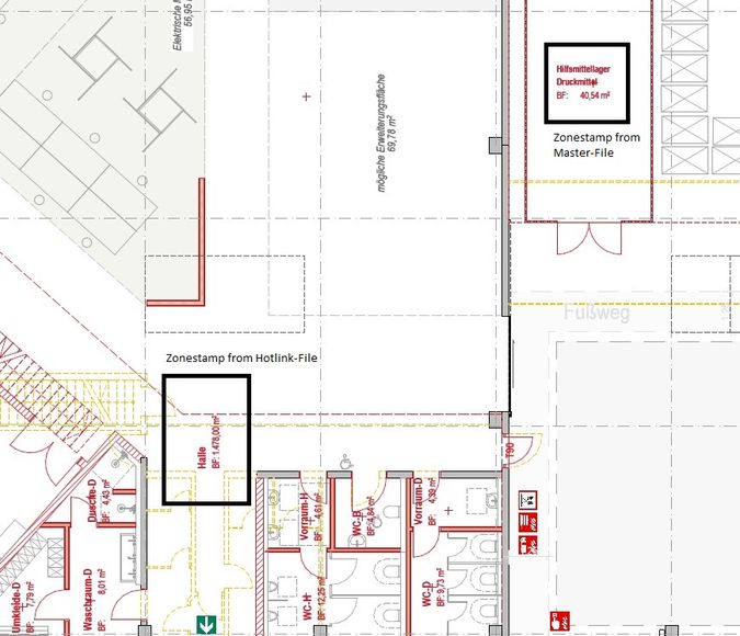

We have a master file - orientation 0° and a hotlink file that is rotated 90°. Unfortunately, the zonestamp-label is also rotated 90° in the master file. I have tried to adjust the angle of the room stamp itself, but unfortunately it is always rotated 90° in the master file. Is there a hidden setting or do I have to make the hotlink file the same orientation as the master file?

This settings didn´t help:
Thanks in advance!

Does it help if you set it as fixed angle to screen in the module?
Maybe it will link into the master with the same angle to the screen.

That was it, even though I was so sure that I had already tried it. Thank you so much!
