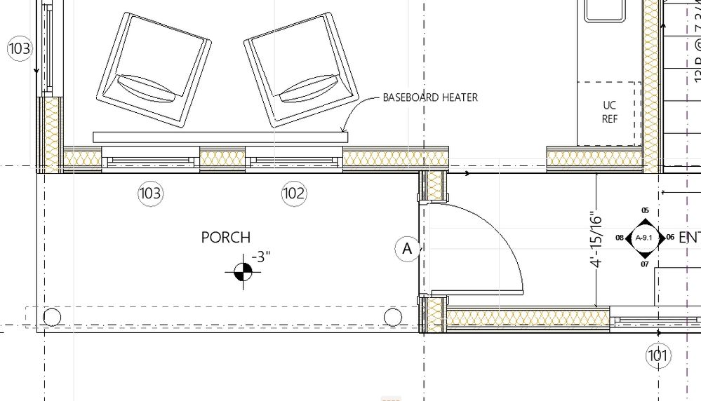

Hi all,
I'm having a big problem with Archicad. The composite walls all of a sudden don't want to merge properly, any suggestions?
2 REPLIES 2
It looks like you have accidentally turned off the 'Clean Wall and Beam Intersections'.
This is from my custom toolbars so may not be exactly the same on your screen.
Can also be found in the VIEW menu > On Screen Display Options.
