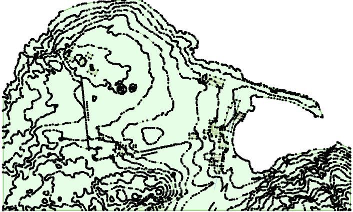

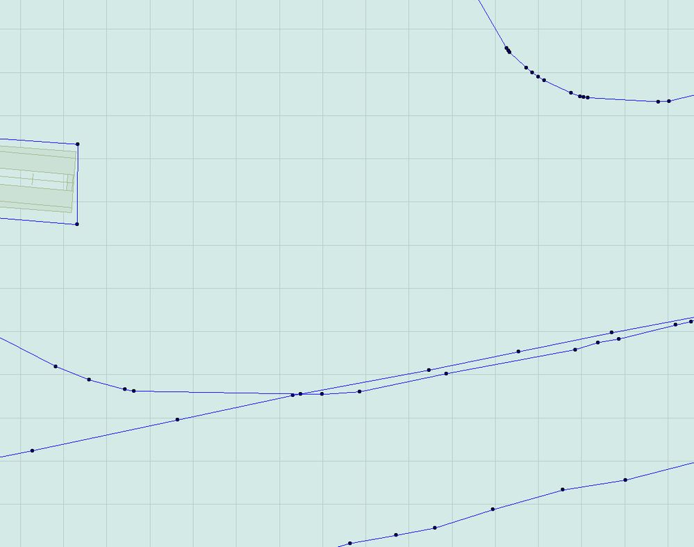

Here is a detail and an overall picture (next post) of the landscape I am working with. It is very difficult to tell which intersections that are causing the problems due to the complexity of the landscape file.
And the overview picture ...
It looks like you should be able to drag the nodes to separate the contours.
Not an ideal solution as you shouldn't be moving the contours but then they shouldn't be crossing in the first place so there must be an error from the original DXF.
Unfortunately erronous and/or incomplete terrain models from the city planning office is the norm rather than the exception here in Norway, so intersecting contours is just a fact of life one needs to deal with on a daily basis ...
Trying to drag one node affected other nodes in unintended and surprising ways, so I was unsuccessful in going in that direction. That was why I was hoping to circumvent the problem by splitting a contour line before the intersection point.
