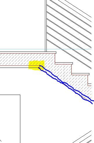

Stair and slab connection in section view
How can I create a clear connection?

Have you tried a Solid Element Operation?
yes but there is little more to go
yes but I still have a problem with the plaster line
Is it possible to add plaster to the bottom of stairs?
Yes. You can add a plaster "roof" just under the stairs. A complex profile would be another way, but the Roof Tool is probably the easiest for you.

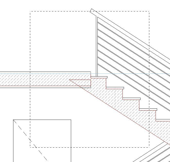

best way is to adjust height of the connecting slab in stairs settings.
After that you can add plaster roof as mentioned in this topic.
If it possible avoid solid element operation.
How about this case? The slabs and stairs should have the same 4 layers, altogether 60 cm thick.
It's not only a plaster layer beneath the stair, which could be a roof, but also two layers above the concrete. The floor covering option for stairs allows me to add the wooden covering, but I still miss the insulation.
