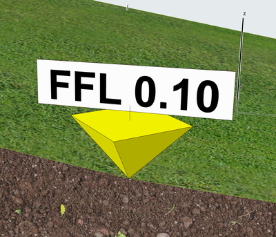

How do I use this?

In the GDL manual the presence of the brackets are to highlight options [, Optional Values ] that may be omitted from the code line. Either omit everything including the  [ ] or just omit the [ ] to set the extra values.
Thanks! Makes perfect sense now you have explained it. Getting started with GDL is a bit daunting, but making progress.
Archicad 27 UKI | OS X 12.7.1 Monterey
Thanks a lot - fixed it!
