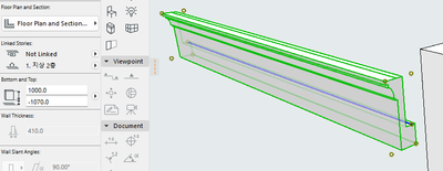

Why is this line visible?
LeeJaeYoung
What did I do wrong?

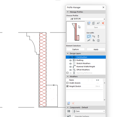

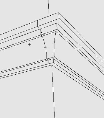

Hello @LeeJaeYoung ,
A line appears when two planes are not perfectly coplanar or if there is a break between two construction elements of the same material or if there is a change of material.

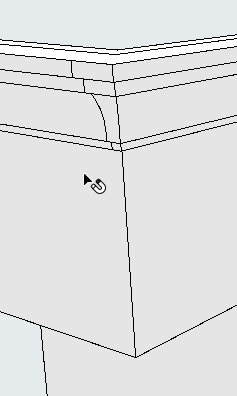

@LeeJaeYoung Please add a signature with the version of AC you are running and platform win/Mac? This may be an old bug. Does it happen at all corners?
AFTER INTERSECT
