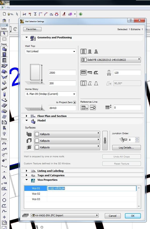

I am working in a big project where we are using archicad an VICO control.
Archicad is with help of VICO control adding new proprieties to the selection settings for better element organization. (se pic)
Is there a way to use this also has a criteria in Find & Select ??
It would be very very helpful if i can filter element also by this new criteria.
Thank you all for your time!

I don't have VICO but I am not sure this is possible.
There may be a workaround solution to this: create a Schedule which lists these elements and then you can select a row and show those elements in the Floor Plan or in 3D. The trick is to create such a schedule criterion that will display all the elements you want to select in one line.
Let me know if this works for your case.

That did not work.
Then I have no more ideas. I am afraid this may not be possible to do since those are fields created by an ArchiCAD Add-On, not ArchiCAD's core functionality.
