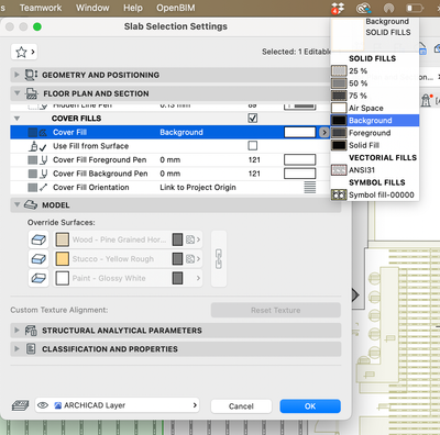

ive created a 3d building and want to add hatches to the plans and sections - except when I press cover fills only transparency options come up eg 25% 50% 75% background foreground. then also when I go view, onscreen view options, there is no option to press vectorial hatches

this is what i currently have as a cover fill option. keily_0-1661844507085.png
this is what i want to have, so that I can add hatches to my 3d objects in plans and sections.

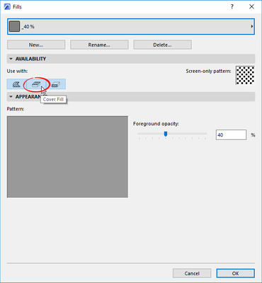

Have a look at your fill settings and see if all the fills you want have got the 'Cover Fill' option set.
created the building from walls and slabs and basically just need to show basic hatches like brick for walls and concrete grounds
this is what mine looks like 😞
Yes, that is good for the 'Foreground' fill.
That is why you can see it in the cover fill options.
Check the settings of all the other fills that you can't see as cover fills - i.e. the 'Asphalt' fill that doesn't show in the cover fill list.

But shouldn't there be those coloured dots in the fill settings window?
You should be able to see ALL fill there.
