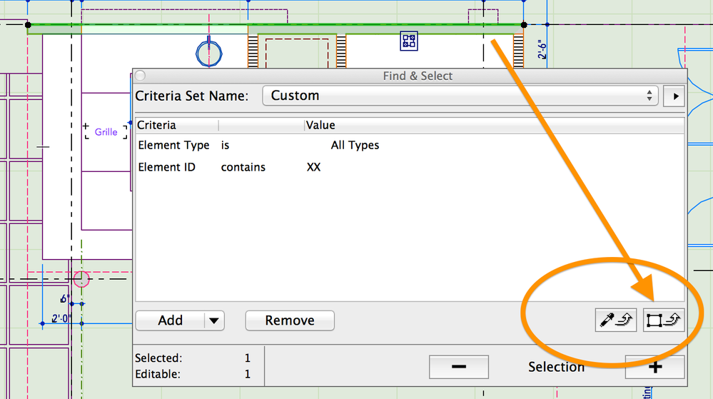

The Operator on the SEOs have to be placed on a specific layer (z-SEOs for example) and that layer has to be turned off.
Find and select picks the settings from the object that you have selected using the icon with the square and arrow.
Not all the fields can be written to.
The procedure basically is:
1. select object that has the settings you want to use for F&S
2. Hit the button for the square
3. Keep adding to the fields by using the Add button
4. then hit the Plus sign to select them
