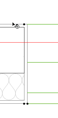

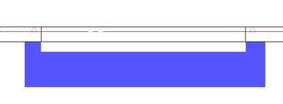

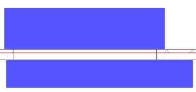

I want to hide HOTSPOT2 for WALLHOLE
LeeJaeYoung
1. So I made it because I needed Hotspot2 for WALLHOLE in the structural floor plan.
2. So I made it because I needed Hotspot2 of A/2,-A/2 for the architectural floor plan.
I want to hide HOTSPOT2 for WALLHOLE created in step 1.
Is it possible?
3. I want the hotspot to be on the structure in the structural plan. I am wandering to catch the invisible hotspot2 point.
4. First create A/2 without using gs_right,left_oversize and
I tried to create wallhole hotspot2 in the structural plan.
However, when Show opening only is selected in MVO, hotspot2 created in 2d script disappears.
Can hotspot2 be shown in MVO Show opening only?
When you activate the 'Show opening only' in the MVO, the 2D script of the window objects is no longer run.
So any scripted hotspots will not be there - nothing scripted in the 2D script will be there.
You could try scripting the hotspots in the Master Script - that might work, but I am not sure, I have never tried it.
master script
HOTSPOT2 0.5,0,111
The conclusion I tested is that it doesn't appear.
I can't agree that 2D script doesn't work.
This phenomenon occurs because wallhole2 is working.
