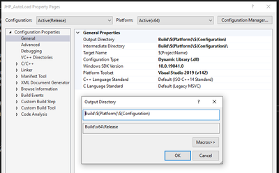

Build started...
1>------ Build started: Project: JHP_AutoLoad, Configuration: Release x64 ------
1>Compiling the localized GRC file...
1>JHP_AutoLoad.grc
1>
1>
1>G:Build\x64\Release\\RO\JHP_AutoLoad.grc.rc2.i (29) : Extra character on line  (ResID: 32000)
1>
1>Write_Error: Extra character on line  (ResID: 32000)
In 1>G:Build\x64\Release\\RO\JHP_AutoLoad.grc.rc2.i (29) : Extra character on line (ResID: 32000)
The drive letter is correct, however the first backslash is missing between G: and Build.
There are two backslashes between Release and RO.
The full path is accurate except for a few folders upstream of Build.
G:<\><folder><\><folder><\><projectname><\>Build\x64\Release\RO
is the real path I am looking for to avoid this error.
I have looked all over Visual Studio and cannot seem to find where to correct this.
Is it even a VS issue?
Any idea what my options are?
Thanks - chris

MudratDetector
My current error message has new information and is now a bit more revealing with "Output directory does not end with a trailing slash..."
Build started...
1>C:\Program Files (x86)\Microsoft Visual Studio\2019\Professional\MSBuild\Microsoft\VC\v160\Microsoft.CppBuild.targets(499,5): warning MSB8004: Output Directory does not end with a trailing slash.  This build instance will add the slash as it is required to allow proper evaluation of the Output Directory.
1>JHP_AutoLoad.grc
1>
1>
1>
1>Compiling the RC2 file...
1>Microsoft (R) Windows (R) Resource Compiler Version 10.0.10011.16384
1>
1>Copyright (C) Microsoft Corporation.  All rights reserved.
1>
1>
1>RFIX.WIN\JHP_AutoLoad.rc2(11): fatal error RC1015: cannot open include file 'JHP_AutoLoad.grc.rc2'.
1>
1>C:\Program Files (x86)\Microsoft Visual Studio\2019\Professional\MSBuild\Microsoft\VC\v160\Microsoft.CppCommon.targets(241,5): error MSB8066: Custom build for 'RINT\JHP_AutoLoad.grc;RFIX.WIN\JHP_AutoLoad.rc2' exited with code 1.
1>Done building project "JHP_AutoLoad.vcxproj" -- FAILED.
========== Build: 0 succeeded, 1 failed, 0 up-to-date, 0 skipped ==========
And, sure enough...
But adding the trailing slash generates the same error [1>G:Build\x64\Release\\RO\JHP_AutoLoad.grc.rc2.i (29) : Extra character on line (ResID: 32000)]
without the pushback of the trailing slash problem.  Very counter-intuitive for me...

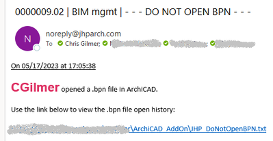

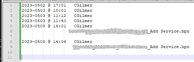

When users open a .bpn file [in 24, and now in 25], they get...
an annoying notification at File > Open, at every selection, at every deselection, and at every zoom/pan while something is selected:
their own personal entry into the log file:
And...  We get an email:
Hopefully, this gets the message across.
